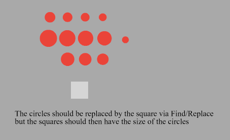

  • Is it possible to use Replace (Find/Replace Function)
    to replace a Shape with another Shape and retain the
    previous size for each object?
    I know the way @b77 described in this Thread here.
    But with this method, all replacements have the same size.
    https://www.vectorstyler.com/forum/topic/2028/how-to-create-letters-made-of-circles/12
    And I know that there are some additional options in the Find/Replace function.
    But I could not find a solution for my question above.
    So, maybe someone with more knowledge than me can help me out?
    Here a Picture what i mean.
    And thanks in advance
  • @Subpath It would be cool to be able to do this, but I don't know if it's possible.
    @Subpath Not possible with ellipse and rectangle shapes, because these are not "scaled" when the Transform tool is used. For these shapes, the Transform tool modifies the shape parameters.
    One way to go around this is to have the circle converted to curves before scaling to various sizes and then duplicate and scale.
    I will add an option (in the next build) to use scaling instead of changing shape parameters for all shapes.

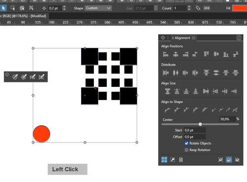

  • Here why i came to this question.
    First
    Because of the shear amount of options "Find/Replace" seems to already have.
    But i dont know, how to use any 🙂
    Second
    Most steps seem to be already possible in VS. But only manually.
    Resizing Objects:
    I like resizing via Alignment Size
    because it will align the Size from any Shape to any Shape
    (works also with blended Shapes, i use blend often to get
    a bunch of colors or sizes)
    Here a Video:
    Change Shapes:

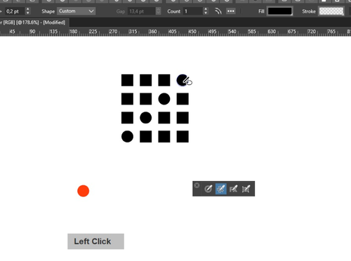

    I use the Shape Picker Tool, could also change Sizes
    (works also with blended Shapes)
    Also a Video her:
