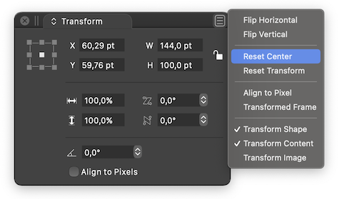

Sometimes I need to reset the center of an object. Sometimes I need to set the center of an object (for rotations etc) to be elsewhere on the page. How can I reset to the object's center? How can I numerically position the center rotation point?
@badcat To reset the pivot, choose 'Reset Center' from the options menu of the Transform panel:
You can also drag it with Option-Shift, which lets you move it back to the center of the bounding box.
I don't think numerical positioning of the pivot is possible atm.
@b77 thank you. Still would like numeric positioning.
