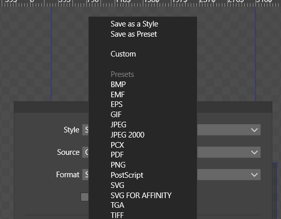

    Saved at least 100 times. I have a preset SVG FOR AFFINITY.
    Maybe VS does remember some of its settings, maybe all, I don't know, but until MY actual preset name doesn't show in the panel as active, while doing another Export, it doesn't look right.
    @plrang Normally, VS will remember all the export settings if the document is saved after exporting.
    But it might be that the preset name is not stored. I will fix this.
  • @VectorStyler Seems like something is stored, but it doesn't show up as an active one.
    Also this thing is so confusing Style, Custom, Preset...
    Plus, the SAVE and LOAD hidden in those menus are not user friendly, should be visible in every panel which does the SAVE/LOAD.
    @plrang Yes, "custom" should not show up as a selectable menu item. It is a label in case of any value is changed.
    Styles and Presets: there is a long explanation for this, but basically these are different ways to use stored options (available for most things in VS). Styles are used to keep active link to the stored option, and when they are changed, all used cases are updated. Presets are copied, without links.
    Styles / Presets for export settings make sense only when used in context of batch artboard/slice/object exporting.
    I would not move Save commands out of this menu for all cases (lots of such drop down in the UI) as it would make those views / panels more complex.
