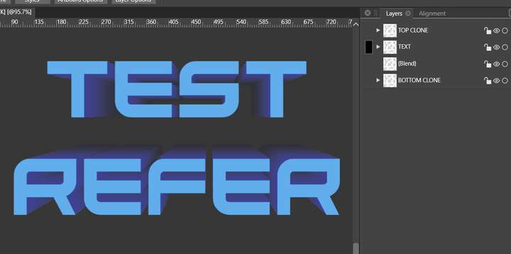

I found there are those References and Clones, Clones are great, but VS keeps crashing while using it
@plrang do you need references and clones for what you were doing (I saw your original screen shot)? I've made similar things without
Keeps crashing while I'm trying to make some simple changes, like the CLONE color or TEXT color etc. Impossible to work with that.

Yes I sent 1 report, the crash repeated just with the described operation.Cloning is cool but unfortunately Blend doesn't seem to consider clones or references, references don't consider changing object parameters, like colors.
And cloned groups of text don't seem to pass on text changes. But I can't test that because the program crashes all the time.

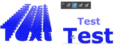

It is also possible to change your Text using the Shape Picker Tool.
(also more then one Text)This way you dont need Clone or Reference and Blend could stay as it is.
Note:
If Shape Picker Tool is selected, to hold the Ctrl-key
will bring the Transform Tool up for faster selection
.Your new Text should have the right size for the Front and Back Line.

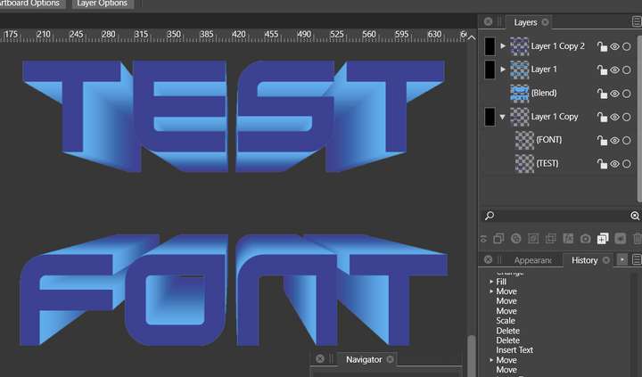

@Subpath But I would like to change the TEXT to ANOTHER TEXT while keeping all the transformations and not having to change the string a few times.
@VectorStyler Thanks, just tried that and it works, but I don't understand why is that so complicated.

@plrang said in Blend mode made easier?:
The Shape Reference or the Styles approach?
For the styles approach, obviously we need to create, apply and then if want change the style, so this will incur some steps.
For the shape reference approach, again we need to setup (define) the reference shape and then use it.
If there are fewer steps to achieve this, suggestions are welcome.
@VectorStyler Thank you, I wanted to describe the problem and was trying to create a simple graphics for it in VS, but it won't let me do it. I have to wait for an update.
