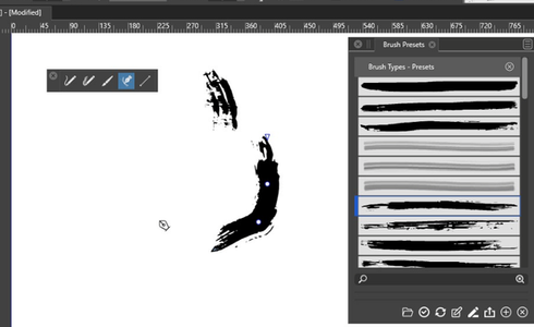

I'm sure nobody bothered to consider my idea because I didn't bother to post a mockup.
There you go — show the Brush dropdown in the context bar when picking the Pen tool, before even placing the first node:
I don't understand that instead of weighing things
up and conceding the other side their interests too.Why you create threat scenarios with Inkscape and Gimp
and talk down the Idea this way.
appreciate your Idea, but i am not really shure
if i get it right.If i use the Brush Tool it looks already that way
like in your Picture.And your Idea seems that the same should show up
when we use the Pen Tool, its fine for me
