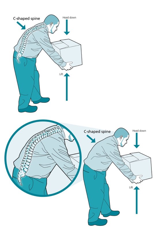

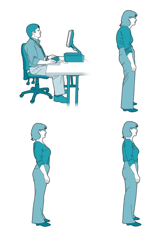

It's default global palate has dug me out of a fair few holes over the years to the point that when I had an NHS illustration and layout job which needed aprox 150 Illustrations, I chose InDesign instead of Illustrator to do the illustrations, because I was aware how the NHS committee meetings would usually go through alternate spot colour changes (these leaflets and booklets where usually Black and a spot - see examples) before (on most occasions) ending up going back to the first version.

@Dazmondo sorry (for those who aren't aware) forgot to mention how easily this was achieved: I'd create the full set of Illustrations in Black and Pantone 321 (the colour above) then various people on the committee would want some input so maybe request using a green or purple - in Indesign select and add maybe standard Pantone Green and Purple then drag Pantone 321 to the trash, which would flag 'replace colour' choose Pantone purple = job done - all pages updated - make multipage PDFs of further colour variations - such a missed, taken for granted feature, that makes these situations a two second fix.

does not match the topic
but I like the illustrations and the color choice.
@Subpath said in Option for global colours by default?:
but I like the illustrations and the color choice.Thanks Subpath - if I remember right, that was my original colour choice, for that particular job, and after around 5 colour revisions, (and around 2 months later) this became a super rush job and the committee decided to go with the original in the end - all the colours had to be chosen from either the set of seven NHS corporate colours or the extended palette which I think was around 16 or 17 spots and cmyk breakdowns, which also included the 7 base corporate colours
