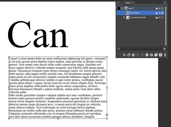

I cannot convert a text frame to curves
I can select convert to curves, but it doesn't do anything. After that convert to curves is grayed out. But artistic text can be vectorized. Windows.
Try : text-> "Convert to Shape Text" first, before converting into curves

It is not a bug. When a text frame is selected, the convert to curves will act on the "frame" shape.

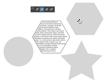

BTW: it is possible to copy/paste any parametric shape (ellipse, polygon, star) onto a text frame as the shape of the frame and then edit the shape parameters.

I will agree with @Ingolf here... This issue becomes a nightmare if you have a text frame with more than one column or row and the suggested method of Convert to Shape Text will not work. The layout of the text frame is altered.
As already suggested by @Ingolf, wouldn't it be better if one could just click on the Convert to Curves command to efficiently and accurately get the job done?

Since the Convert to Curves in this case works on the text frame, what about having a separate action (menu item) for converting the content of a text frame to curves?
I would expect it to convert text frame and contents together.
VS could also ask the user what to convert rather than populate the user interface with more choices and items.

Now that I understand it better, I would not expect it to convert text frame and contents together.
This makes sense to me and I like having that control over the bounding shape itself. Putting them together in one action may be "easier" for some, but would also limit the options available to the end user.
@VectorStyler Would you be able to elaborate on this some? I was looking in the documentation for the steps to replace a text frame with a parametric shape but nothing I tried seemed to work. Most likely user error on my part.
But this ability sounds awesome and I'd like to do it
@Boldline Select a shape and Edit -> Attributes -> Copy Shape. Then select the text frame and Edit -> Attributes -> Paste Shape.
