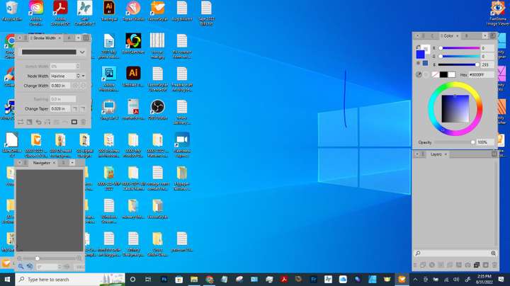

Lost background canvas of program
No, jun run VS, it will start from scratch with default settings so you'll have to restore the license file or re-enter license code.
That didn't change anything. Still only the panels showing. It did not reset to default. Bummer.
That is strange, we just removed every bit of configuration from the equation. How is your setup, external screen and laptop, both screens on?
not sure what you mean abut setup, external screen and yes my laptop screen is on. I was using my ipad as a drawing tablet but that is turned off now.

@Ingolf--I have completely removed all traces of VectorStyler from my computer, re-downloaded from site, reinstalled. and darn it , I still only see panels. No place to put in software key. The thing is, it was working with ipad as drawing tablet screen along with laptop screen UNTIL I tried to put toolbar Horizontal. I cant even use the program right now. there is probably an easy fix, I will just do something else until I hear more.

@SJStalter On the bottom left corner of the screenshot in the first post I see the VectorStyler window title icon.
It should not be that small, but can it be resized?EDIT: red circle around the possible VS window. But it should not be at that size.
Yes i found it. Yesterday the Navigator panel was covering the critical part. I've resized it and now have my program background. Thank you so much!
