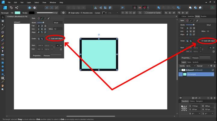

I tried to turn on the Transformed Stroke checkbox in File > Document Setup > General and scaled an object using Transform Tool, but the stroke width of object didn't get increased. Here is the file:

I really appreciate how in Inkscape this is solved by a toggle at the top of the screen. In this post https://www.vectorstyler.com/forum/post/17146 @VectorStyler indicated that it was added to the backlog, and as it may need a different option, for your consideration (these are toggles, all related to scaling, they appear super conveniently in the select & transform context menu, and of course not all are applicable to VS):

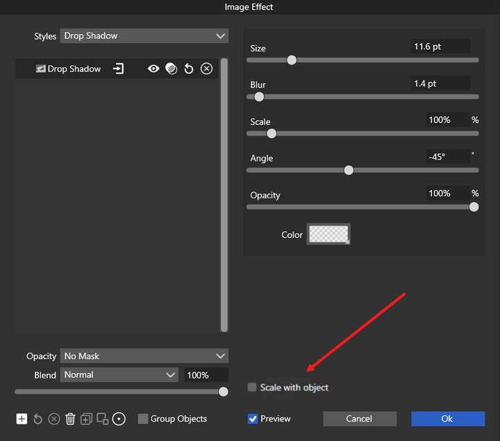

The main issue with the context panel now is that it is way too crowded with options and buttons, and I need to add customization for it to have more space.The Transformed Stroke option in Transform panel menu, Object Options and Document Setup is not the same as Adobe Illustrator's Scale Strokes & Effects feature.
Please see the video and the example in this thread:
@gotanidea said in Scale Strokes and Effects:
Yes, these are different. I will try to implement a similar transforming mode. The problem is that it might conflict with existing features.
