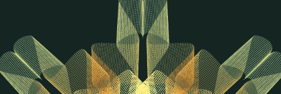

@VectorStyler I was "playing" with blending, stroke shape etc. Why do I get only a few dashed blended strokes/lines when I select "dash" in the stroke panel ? see below:
@PatrickM I think the dash attribute is not blending correctly. I think this might be a bug.

@VectorStyler I can open old adobe files but I don't get what I did.
I did this years ago in Adobe Illustrator :
When I open the file in VS:
@PatrickM Got the file, will try to replicate it.
@PatrickM I would need the AI file to replicate this issue. The problem occurs when importing the effects from AI.

@VectorStyler very strange: the file looks fine with W10 (gtx1070) but it's chaos with W11 (gtx3080).
W10
W11
@PatrickM In Windows 11, select Software mode n Preferences -> Performance.

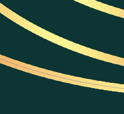

Then, I've changed the performance to OpenCL: still weird rendering --> again to Software, still weird rendering --> repeated twice......... I've closed VS, start again and it was a bit better but the strokes/lines are still "jaggy" (??), please, see below.
The rendering is very nice on my W10 computer. The gpu drivers are up to date on both computers.
