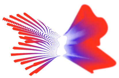

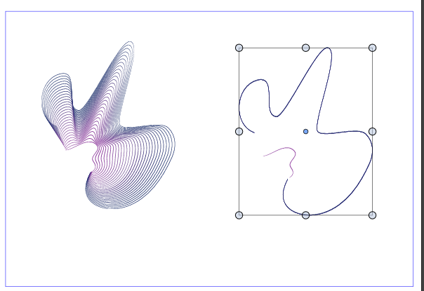

Blend, artefact when changing gradient shape

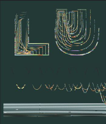

I might have an intel gpu on the mother board but I don't know whether it is used. How can I know ?
Thanks.
@PatrickM If "Software" mode is selected, then the GPU is not used.
But then it is hard to say what is going on.
Another thing that might cause this is the DirectX display on W11.
But this is not possible to turn off.
I open a bug on this one.
@PatrickM One more thing to try: set the document mode to RGB (it was in CMYK in the file).
The document title tab should display RGB rendering mode.

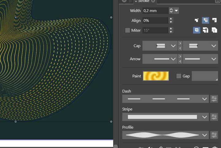

@VectorStyler If I did correctly [Effect --> Adjust Colors --> Color Mode --> RGB], it did not change anything, at least immediately.

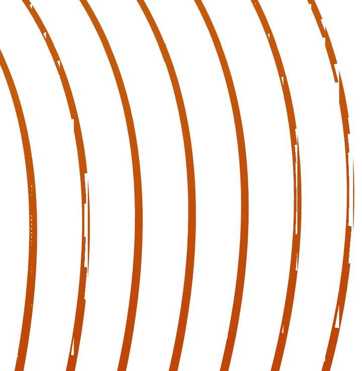

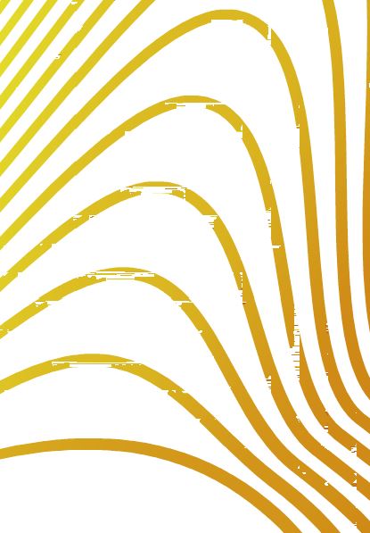

Then, I've changed the performance to OpenCL: still weird rendering --> again to Software, still weird rendering --> repeated twice......... I've closed VS, start again and it was a bit better but the strokes/lines are still "jaggy" (??), please, see below.
The rendering is very nice on my W10 computer. The gpu drivers are up to date on both computers.

Anyway, a fresh computer start & the document rendering is now fine with W11.

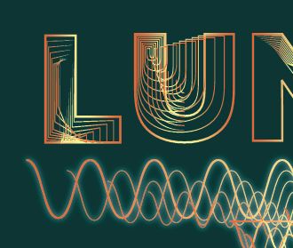

@VectorStyler I have another AI file that doesn't open nicely (with all features) in VS. Is the next update going to fix this issue ? Thanks for any feedback. Cheers.
