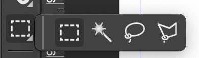

    @ncic Got it now. The magic wand selection mode is active (in the toolbox).
    Select the first one in here (the second is visible in the video).

    @Boldline There is a task (for later) to allow box selection in magic wand mode also, but it will still act as a magic wand (select by style).
    So not for now.
  • @VectorStyler Yes the box selection option for the magic wand will be a cool and useful addition when it gets added.
    The issue that @ncic seems to have had and that I've also run into is that when you are finished using the magic wand tool, you have to remember to go back over to the tool bar and swap it back to one of the other selection options. If it remains on the magic wand, then other tools do not function properly and it feels like VS is not working correctly.
    Perhaps the best answer for now is to assign a keyboard shortcut to the standard box selection? This way, when finished with the other selection tools, it's easy to hit a key and go back to "normal' selection mode? Or maybe the cursor has an asterisk next to it when in selection modes other than the standard rectangle select? that would at least give some visual feedback that something is different about the selection
    Another option could be to reverse the color of the icons for the other selection modes aside from the standard box selection so you can visually see that you are in a mode that needs to be switched back from to use other tools
  • Another idea would be pressing the same key a second time when done with the magic wand. ... so for example, once you are done using the magic wand, you press the "M" key to revert back to the box selection. the same would be true with the lasso and polygonal lasso (though to make this work a key would need to be assigned to the polygonal lasso)
    Much the same way we can press "A" twice to flip between the node selection tool and the transform tool.
