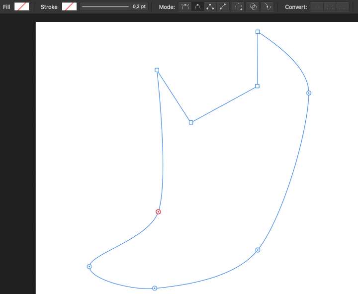

  • @VectorStyler Just a little movie of smart nodes in Affinity Designer. As you can see this smartnodes and the algoritms behind calculates a smooth curve between the nodes as you draw. If you later move one of those smart nodes, the curve is recalculated. As you can probably imagine this speeds up handtracing and other workflows dramatically and it eliminates the issues with muscle strain I described earlier.
    I don't think you need to add smartnodes 1:1 - a new nodetype - I rarely use them for fine tuning - but the automatic calculation of the curves between points makes drawing detailed objects and especially detailed documents easy peasy and fast. The real and almost extreme value lies in the fact that you can draw hundreds of curves without the laborious and physically demanding process of dragging and clicking slowly, but simply clicking and moving quickly and easily.
    So I suggest a mode that when enabled works exactly like this and of course - when for example the Option key is pressed - draws straight lines.

    Yes, looks that way. I didn't use it much in Illustrator since Affinity is so much more pleasant and fast for handtracing and constructing extremely detailed drawings, but it seems to be pretty much what I request.
    But not another tool and more choices. The difference between modern drawing programs and Illustrator is that newcomers tend to keep it simple and make fewer and better more flexible tools. Serif integrated the curvature tool with the pen tool and smart nodes update themselves and the curve after drawing the curve. As usual the algoritms Serif code suck compated to Adobes, though.
    So I would personally prefer an option in the context toolbar that enabled this mode until I disable it.

    Ah, yes, but I hope it will not be a 1:1 implementation of the one in Illustrator - a separate tool. 🙂 Using many different tools for a job is a thing from the physical world, here (in sofware) we can merge a few tools into one single tool.
    The beauty of what I have in Affinity Designer - even though the algorithms are a bit sloppy - is that it kind of does it right while only creating smooth nodes ad libitum. Correcting them manually later is easy and fast and doesn't require me to switch tool, toggle any settings or hit any keys. This is key when working with very detailed designs and art. When you have to draw hundreds and hundreds of nodes speed is important - not precision.
