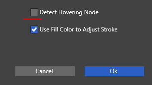

@VectorStyler E-mailed you the settings but quickly found the root cause:
Disabling 'Detect Hovering Node' causes this:
@Ingolf Got it! And thanks for identifying the root cause, I will fix this ASAP.

@VectorStyler said in Pen tool icon not always displayed:
We'll it isn't - but toggling that state immidiately turns the pen icon on.
