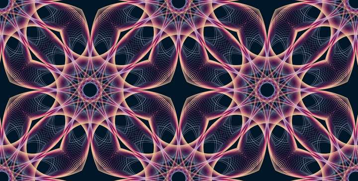

We can get very interesting abstract patterns for eventual backgrounds by changing the type (triangular, rhomboid):
@VectorStyler ... but I would like to know if it is possible to change the colours of the pattern once the object has been defined as tile.
@Pat said in WIP - Testing Blending: not yet a tutorial but soon for beginners:
Yes, but first the pattern tile must define those colors.
Basically any style used inside the pattern tile (content) can have an override selected using the Style Overrides from the pattern menu.So use color styles inside the pattern content, then define the pattern content as a "Style" (not a "preset").

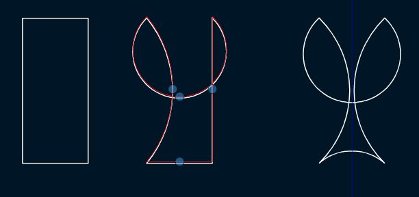

@STEVED Hi Steve,
The starting scheme is indeed one rectangle which is a parametric shape that can be modified in VS using the 'Node tool' (bending of each side).
Then, the object is copied (once or several times) & its/their size(s) adjusted as wanted. The blending of the (two) shapes and the rotation (Oject--> Transform--> rotation) of copies do the overall design.

I consider myself a very beginner in the use of VS which offers so many possibilities. I haven't gone into detail to avoid being redundant with what is already presented on this forum & if you want help with blending, here is a tutorial made by @Subpath.
@STEVED, @Pat
I would like to add the following regarding the parametric shapes
VS has two ways to handle parametric shapes
(smart shapes)The first way is to use the Shape Editor tool.
When you select a parametric shape with it, you
will see blue dots that are used for manipulation.The second way is to use the Shape Panel.
Which offers sometime some additional options.
With Shape Panel you change the Shape Form
by changing the values in the input fields.
This may be helpful for creating more precise Designs.here a little video how it works

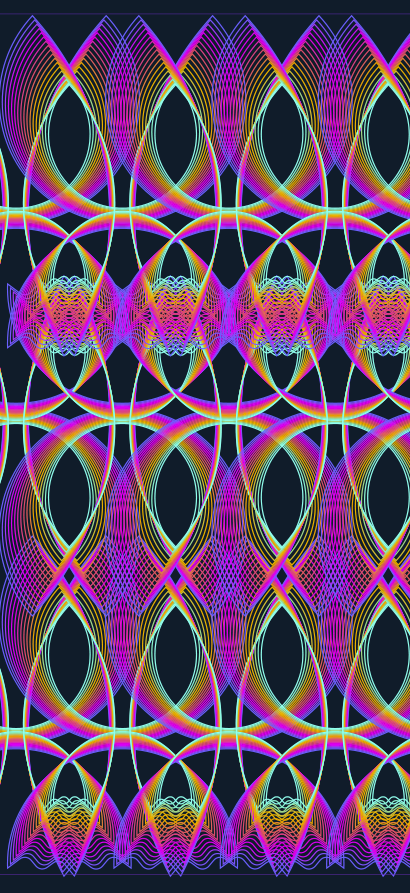

Once a pattern of interest is designed, the 'Repeater' function can also create interesting patterns.
@Pat
looks great
how did your computer deal with it ?
