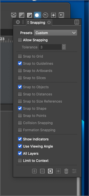

Not easy to activate the snapping options icon to adjust settings

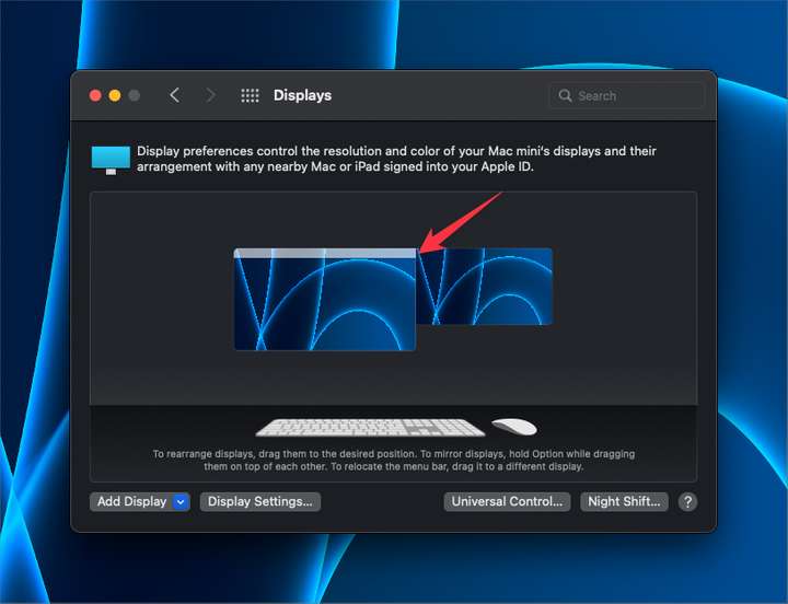

I use my wacom cintiq as my primary monitor and then have a secondary standard monitor attached as well. Even though in real life, I have them one over the top of the other, in terms of mouse movement, I have them arranged with the secondary monitor accessible to the right side.
So the snapping icon is on the far right corner of my main screen but that also borders the secondary screen. If I move the secondary screen to the left side of the main one instead, the snapping button works as expected.
@Boldline Tried to replicate this with a similar dual screen setup on a Mac Mini M1, but it seems to be working here.

I was trying this again now with the 71 build release and still running into the same issue with the snapping icon not opening the menu below on the main screen. when I pull the VS UI over, it works fine as it should. I noticed there's an overlap off the right side of the UI where the snapping panel opens beyond the UI - could this be causing the issue? what if the panel opened flush with the UI?
