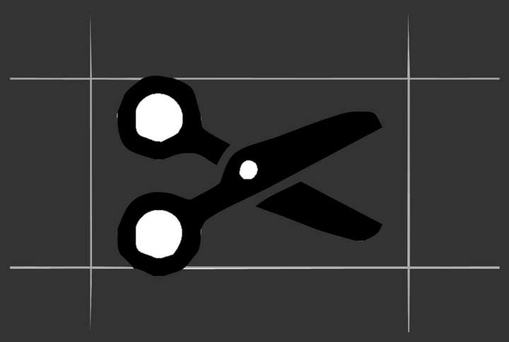

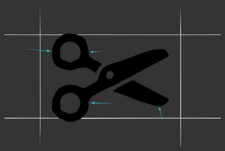

@postdes By "white shapes within the black shapes" do you mean small like these:
…or big like these?
@postdes There is an "Ignore White" option in the Image Trace panel menu, this should be enabled.
If this is not working, send me the image to be traced by email so I can replicate the issue.
@postdes 'Ignore White' is the correct setting for this, not 'Extract Alpha'. My apologies.
