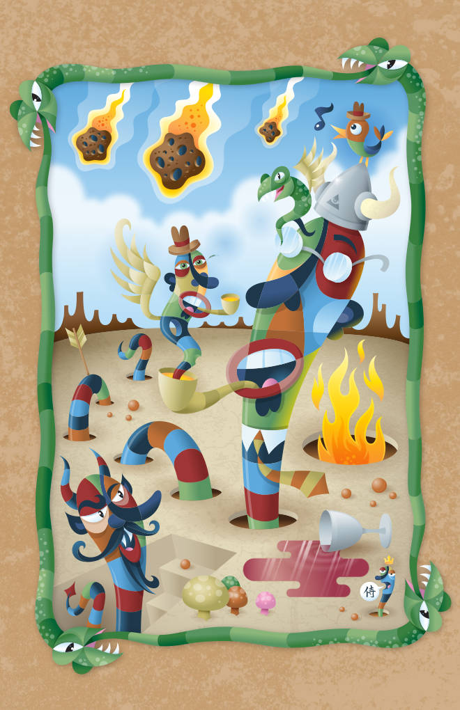

    I always test with the following AI/SVG demo file:

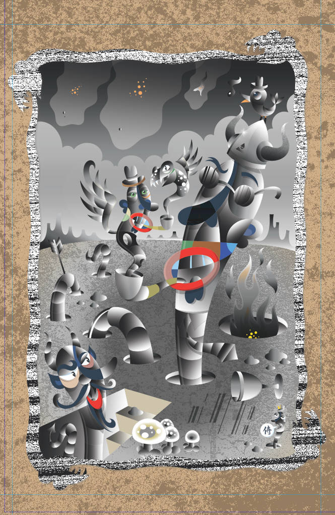

    Loading the AI file in VS results in:
    The file loads in a second in Affinity Designer without issues. PhotoLine and Inkscape will not load the AI, and I converted it to SVG in Designer
    After converting the file to SVG, and I tried to load it again in Vectorstyler.
    After waiting approx. 30 minutes it finally loaded (I do like how the user may continue work on other files while a file is loading, btw).

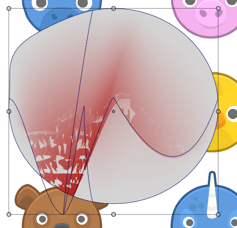

    Lastly, I encountered view corruption of images and mesh gradients (also seen in one of the screenshots above):
    So, I am a bit torn between how feature-rich Vectorstyler is (perspective grid, Width tool: whot! Just like Illy and Clipstudio Paint - one of my favourite tools!), Symbol spray, a rich variety of noise procedural textures, and pretty much a fully featured vector illustration tool. Nothing important seems to be missing, even though I only played around with it for a few days, of course.

    The newest build loads the SVG file quickly and correctly! Quite impressed with that improvement: classy!
    The AI file also works much better, albeit that the textures are missing.
    Dragging performance works a little better as long as the user is zoomed in somewhat. Zoomed out it still is very slow. Is that because of the anti-aliasing?
