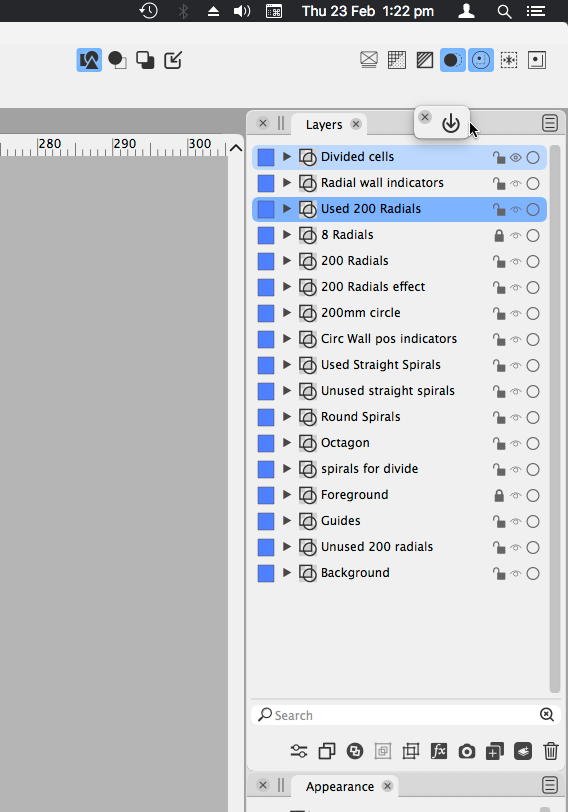

So I work with the layer triangles closed, or with the "Layers Only" option on.The work-around ATM is to leave Select Highlighted off. Created a new Toolbox with just the "Send into Target" button on it, positioned at the top of the Layers panel. Now possible to select on the artboard > highlight target layer > click that nearby button.
VS's deep customisation abilities are handy.
