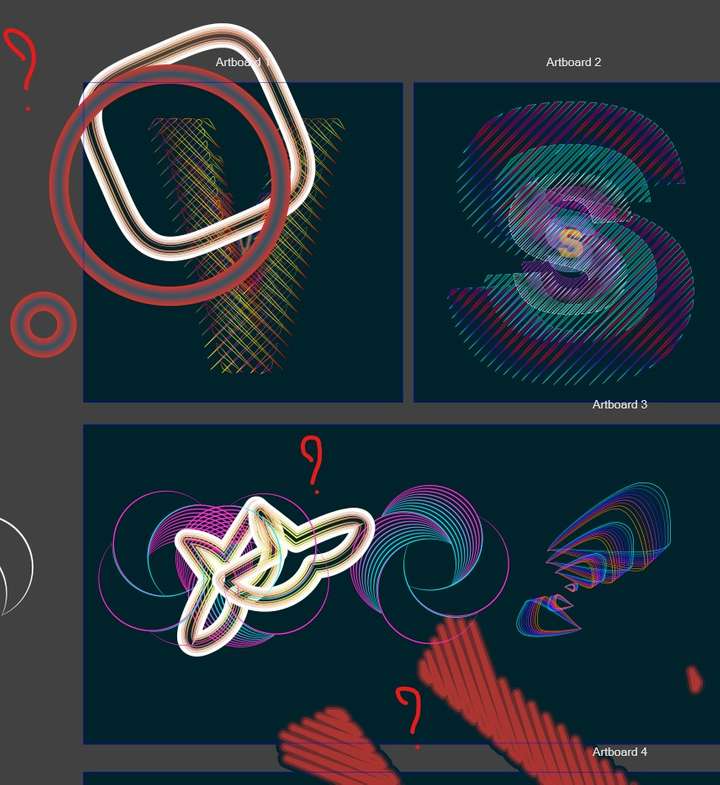

Impossible to reuse an old file with .078
I think it is a bug (regression?). I opened an old file and I can't find the integrity of the objects I created to test VS. Yesterday, I could not duplicate a shape with "Alt-drag"...
@Pat Could be a bug. Send me the file by email and I will try to figure out what changed.
@VectorStyler the file has been sent
@VectorStyler Is it possible to download & reinstall .077 ?
@Pat The problem can be replicate here also. I will get back with more soon.

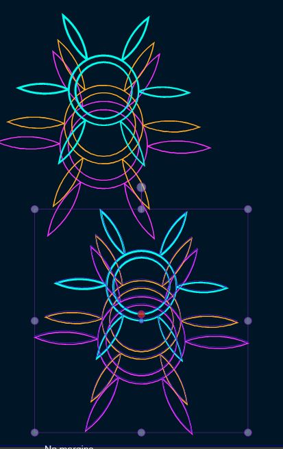

@VectorStyler There is still a bug with copy/paste:
I can select & move this object:
but I can't get it copy with Alt-drag:
@Pat Cannot replicate this with the file I have.
What happens if Command+R refresh us used after duplication?
@VectorStyler I sent you the file.
@VectorStyler I've sent you two files. I've noticed that saving the original file as a temporary one modified the object.
@Pat yes, the duplication is can be replicated. I will try to fix this ASAP.
@Pat Seems to be a mistaken configuration in the release.
A workaround until the next build would be to fix this in the configure.xml file.
On Windows, this can be found in the VectorStyler1.0\vector\data\resource\ installation folder
Search for "allownodestackreseting" in the XML file and set it to "no".
@VectorStyler Thanks but no way (VS doesn't allow me to change the file). I'll wait for the fix.
@Pat The configure.xml file can be edited in a text editor like Notepad or similar.
I edited it here – you can download it from https://www.dropbox.com/s/7sx6iove90t346m/configure.xml?dl=0
