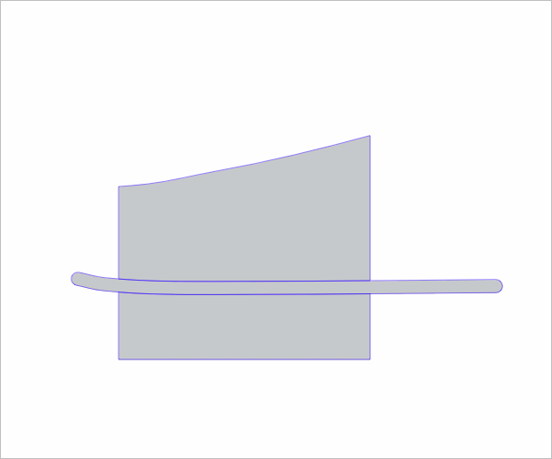

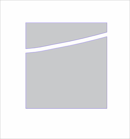

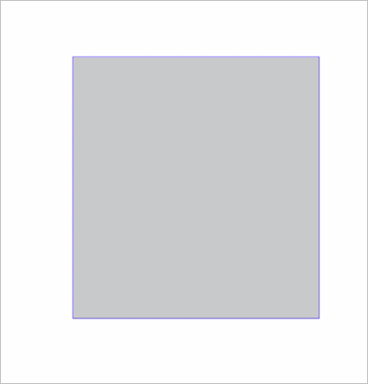

Here is the original shape:
After first cut through with eraser tool:
After second cut through with eraser tool:
@Boldline Replicated, this is a regression.
@Boldline Disable the "Separate path with Eraser Tool" option for now.
