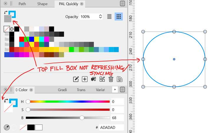

Fill/Outline Box not Refreshing/Syncing (1.1.084 Win 11)
I think I may have reported this issue before, and possibly related to the interface refreshing issues I have had.
The Fill box in the Color Palette Panel does not always sync with the Fill box in the Color Panel.
Last action was clicking on the "no color" swatch in the Color Palette Panel, which removed the fill color in the ellipse and updated the fill box in the Color Panel, but did not update the Color Palette Panel Fill box.
I hope you can squash this one once and for all!

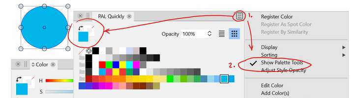

Here are some further findings/details:
I have isolated the issue to the "Fill or Outline coloring mode" boxes on the Color Palette Panel (visible when the "Show Palette Tools" is checked in the Panel Menu).
Using the "Swap fill & outline styles" arrows on the Color Palette Panel does not update the "Select fill or outline coloring mode" boxes.
Using the "Swap fill & outline styles" arrows on the Color Panel updates the "Select fill or outline coloring mode" boxes.
See below:
I hope that helps.
