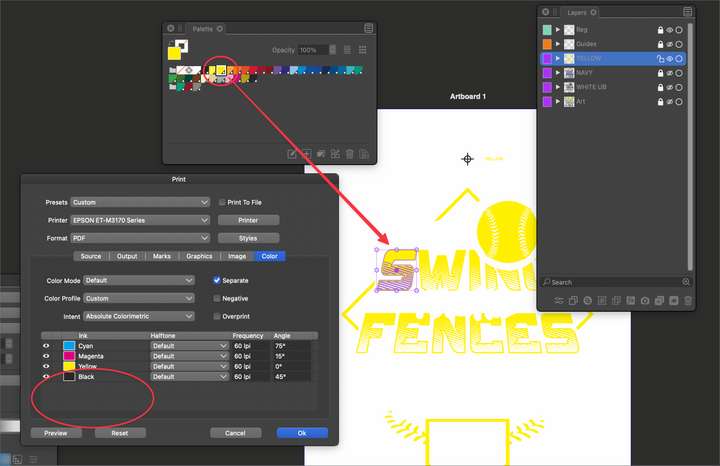

ok that's good. the issue still remains that it shows the spot color options on my main computer but on the client's computer and my secondary machine, it does not offer any spot color options at all. is that something you are still figuring out or is it something else?
@Boldline said in File shows spot colors in separations panel on main computer but not on other computers:

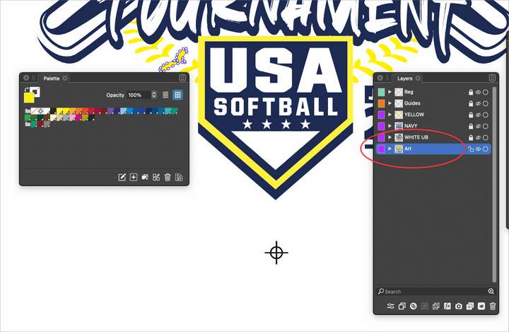

Just thought about this - I had to remove some layers to get the file to upload to the forum. it was just over the 4mb limit. So I had removed the original art layer. All colors in this layer are NOT spot colors... this layer was turned off and locked when I was sending it to print. could that be a factor?

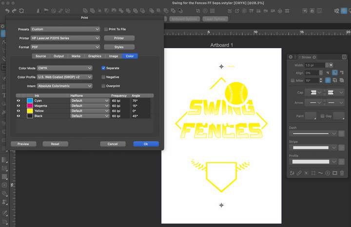

Interesting, when I start VS fresh and open the same file now, I get the version without options for spot colors in the print panel, even though I am using spot colors in the art

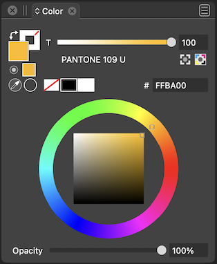

One way to check for spot colors is to look in the Color panel if the color has a single component "T"
@VectorStyler said in File shows spot colors in separations panel on main computer but not on other computers:
Would you be willing to elaborate more on this? Where in the color panel am I looking for the "component T"?

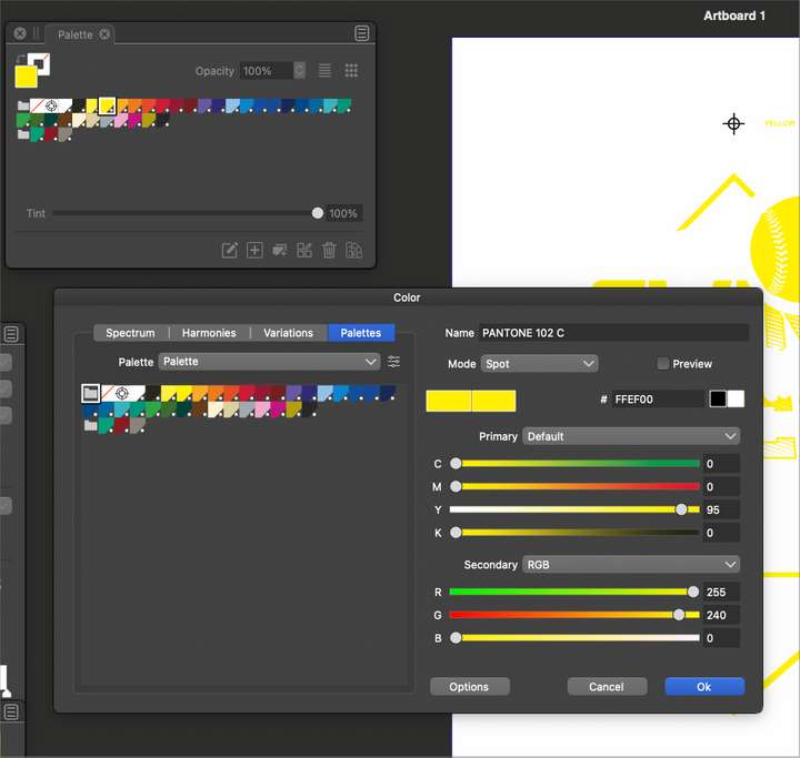

My understanding was that if there was a small white dot within a black triangle in the corner of the swatch in the color panel, it was spot - also by double clicking the color swatch and seeing the mode there is set to "spot"I'm reading through the documentation about the color selector now
Open then Color panel with the Panels -> Color command. There it should have a single component when the object is selected.
