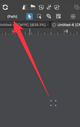

I keep getting a small invisible rectangle that only shows up if I drag over it with the transform tool. I can't edit the rectangle at all. Do you see that same rectangle in the file I uploaded?
When selected, it tells me it's a "path", but I cannot manipulate it at all

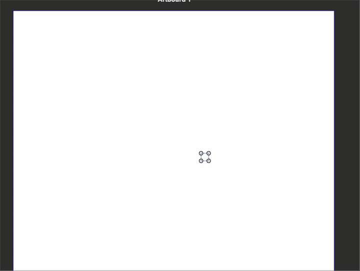

@Boldline The artboard and the canvas look empty.
Dragging over it with the Select/Move tool doesn’t select anything.If I select any of the path objects from the Layers panel, nothing gets
selected on the artboard.

@Boldline The small (single) nodes cannot be scaled (there is no size).
And if they are selected, it seems that the Pen tool indeed is not working.
Try without having them selected, or remove these small nodes from the Layers panel.
I will try to figure out what happens with the Pen tool when these are selected.

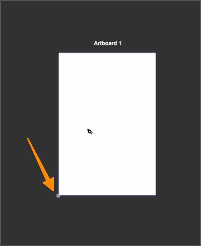

Sometimes I can use the pencil tool to start a stroke and then switch to the pen tool to continue it.Sometimes as I am using the pen tool, I'm getting a small indicator circle at the bottom left corner of the artboard that goes away.

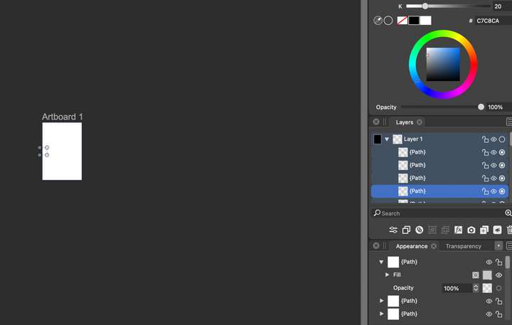

Using the file I sent, I was noticing the invisible boxes show up in the layers panel.
I can select them using the layers panel and some of them, I can scale.
