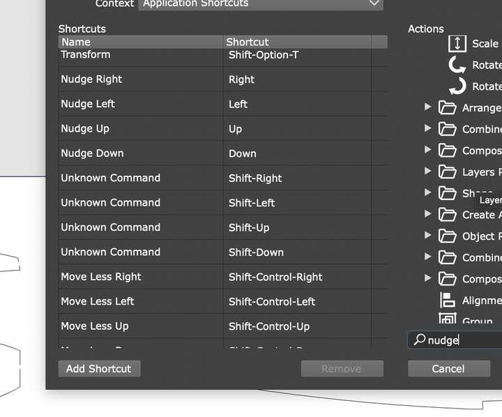

I've never had to do this - even from the start of VS andI've never re-assigned the command to anything else (I wouldn't want to)? I assume that these commands are built-in initially ?
I've attached an image of what I have - I'm assuming there's an issue with the 'unknown command' (shift up/down etc) not being recognised.
The trouble is, there doesn't seem to be an option for 'move more' ie increasing the nudge distance when hitting shift + ???

@Igull One thing to do is to reset the workspace in the app menu.
@VectorStyler said in Shift + Nudge Broken?:
Yes, that cures it but completely screws up my carefully prepared workspace
I have all my workspaces saved, but even after loading any of them, the issue is still there now.
The command is 'nudge more right' (left/up/down), but these commands don't seem to be available in the command set now ??
I'm assuming that's where the issue is because if you remove the four 'nudge more' commands, you can't find them in the right hand panel anywhere to replace them ??

@Igull I will open a bug on this one. Will try to get it fixed in the next build.
