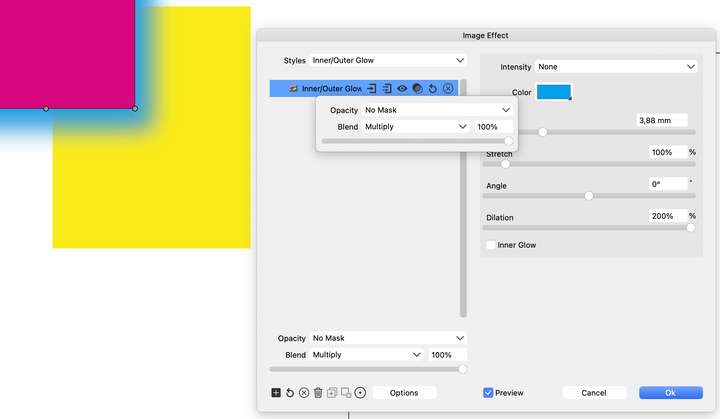

@Ayo Finally, got to inspect this bug more, and it turn out it is not a bug
The blend mode and opacity in the image effect settings controls how the resulting image is combined with the original image (not the backdrop).To combine with the backdrop, use the settings in the Transparency panel.

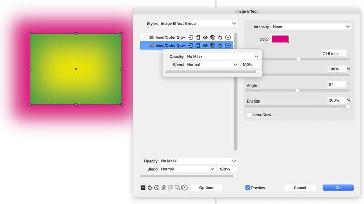

Groupsetting changes/overrides Blend mode setting previously set for specific effect. Can't oversee but I don't see the benefit of it.Second problem while testing a multiple effect I run into the following error.
Situation
- effect 1; cyan inner glow over yellow shape/Blend multiply
- effect 2; magenta outer glow yellow shape/Blend normal

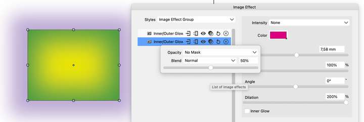

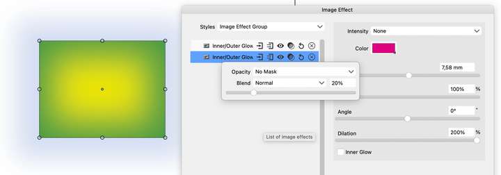

Changing the opacity in the outerglow effect from 100 to 50 to 20% changes the color from magenta to purple bluish. Should remain a shade of magenta. Seems like effects influence each other

Do you mean that the given image example above (magenta rectangle with a cyan outer glow should give a green result on yellow background. Now keeps cyan.) is correct?
@Ayo The image in the original post should be correct.

The blend mode and opacity in the image effect settings controls how the resulting image is combined with the original image (not the backdrop).If that's true, all Outer Glow Blend options would be useless since Outer Glow only reveals itself outside the object area by definition.
Your suggestion to use the settings in the Transparency or Appearance panel to blend with the background concerns the object as a whole. There you cannot treat the Outer Glow separately from the object. Similar to blend & opacity in layer settings.

@Ayo said in Image effect Outer Glow Blend Multiply:
Correct
The outer glow and some other similar effects cannot use blending mode (yet) to compose parts (glow) with the backdrop.There is a task in the backlog to improve Drop Shadow (similar situation) but it will be done after 1.2
