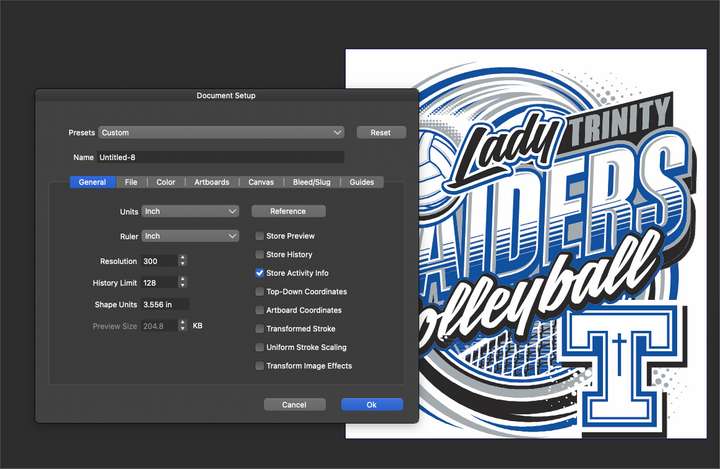

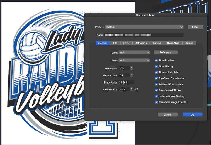

Here is the original art along with the document settings:
Here is the "new from Clipboard" result:
