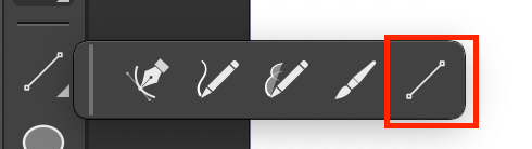

- Draw a line segment with the "Straight Line" tool. Don't draw a horizontal or vertical line. Draw it in whatever angle.
- Switch to the Node Tool.
- Click on one of the node of the line segment.
- Hold SHIFT and move the node in the same direction as the line goes. Now you can extend the line to the same direction it is pointing to. In other words, when you hold SHIFT and drag the node, you are restricting the movement of the node in the direction of the line. This is an extremely helpful setting!
