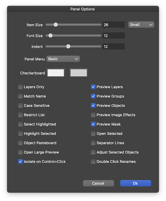

The Layers panel has a menu in the upper right corner, and the last item is 'Panel Options'.
What are the settings here in Panel Options?
@_NM_ Send me the layers panel option screen shot. I will open a bug on this one, but I need some info on how to replicate it.
They are exactly as in the image above, which, I assume, is the default setting for the program.
It appears that alone having opened the settings panel and clicked OK without changing any settings fixed the layer synchronization problem. Thanks again.
