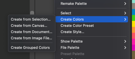

  • @VectorStyler I can see the value of an option to "create new color palette" that would then allow for adding colors to that palette using the hamburger menu options that already exist - create from selection, create from canvas, create from document, dragging colors in, etc. The pieces are already in place for that.
    A newly created palette would not replace the default palette of that in-use VS document file but would allow for easy creation of palettes that could then be swapped out with the default or used as the new default in future documents.
    A new palette could come with the reg black and the "none" by default.
    0_1692358887818_2c2ce1f6-4863-4d22-9f0c-4b6f4462b34e-CleanShot 2023-08-18 at 07.41.11.png

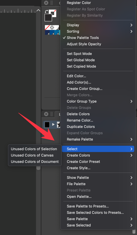

  • @pentool said in Create your own palette:
    but it seems I cannot even SHIFT-select all the default swatches, so I have to delete them one-by-one...? That's somewhat painful...
    I agree it should be easy to shift click all colors between the first chosen color and the last with the mouse.
    There is a current option in the palette hamburger menu to select all applicable colors in the palette at one time based on certain parameters
