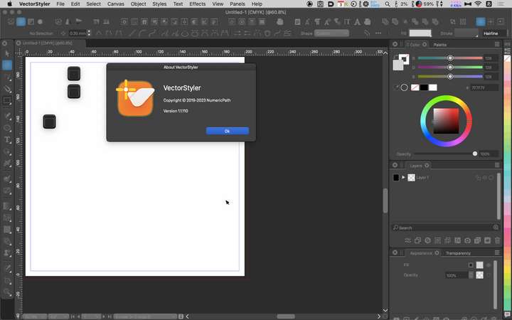

I mean I used them alternately in a day.The main symptoms are
Theme is only Default and cannot be changed.
I really want to use "Flat light grey" but I can't change it.
Palettes are not displayed properly.
Palettes that were iconified in the beta version are displayed in 1.1.110 (this would be great for 1.1.xxx if it worked properly).fig.
Anyway, the problem seems to be workspace related.
1.1 cannot show iconified panels, the panels are still open.
A screenshot might help.
I will try to figure out what happens here. One thing I will try to have in the next build is to have separate folders for 1.1 and 1.2
