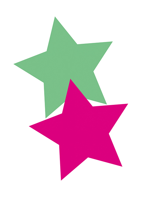

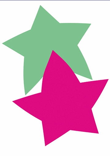

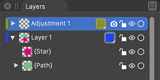

I wonder if there is some obvious reason why e.g. distortion adjustment does not have any effect on exported image (PDF, JPG, etc.), e.g. in this case:
This will be exported without the adjustment effect in at least JPG and PDF formats:
