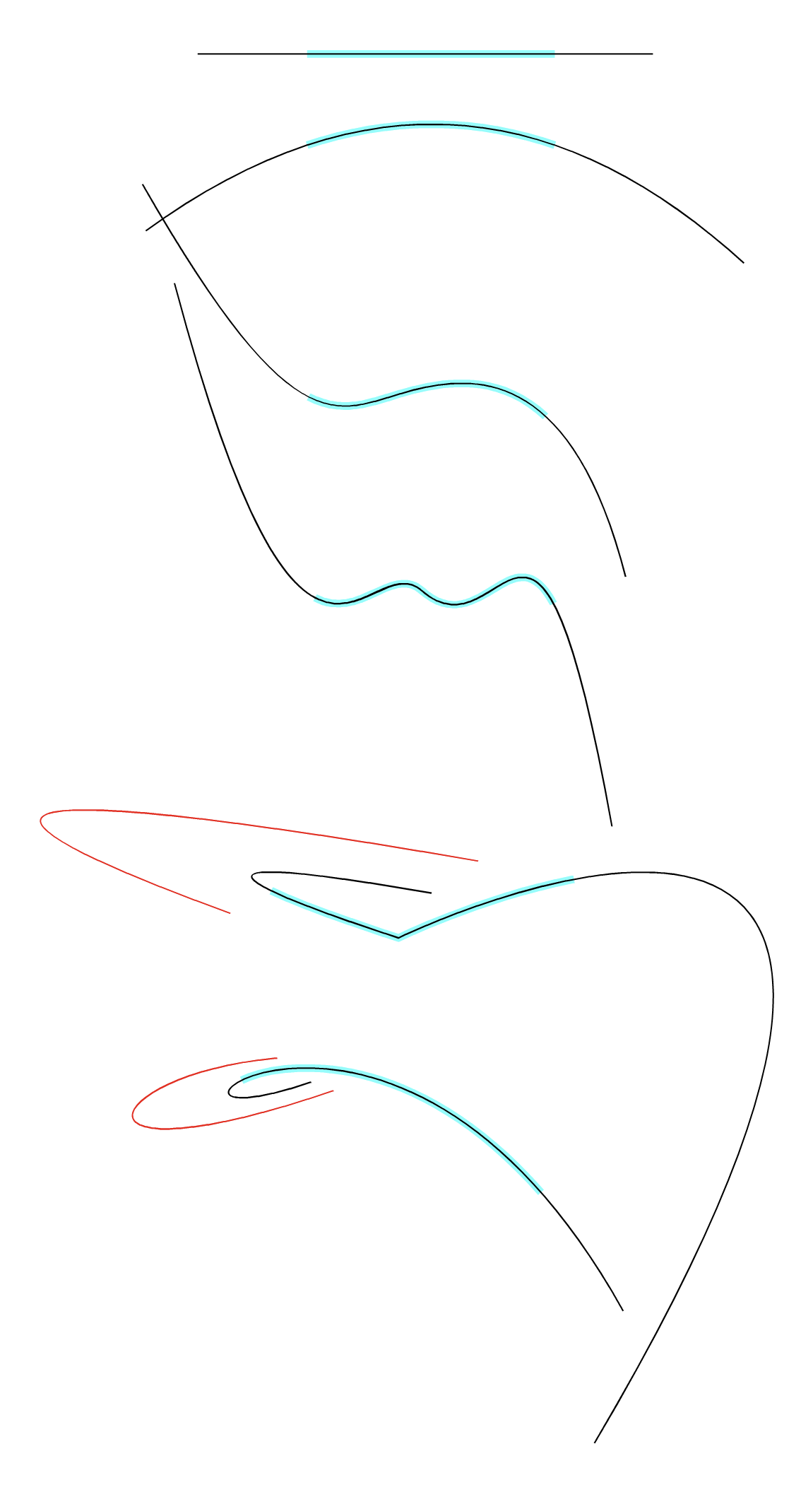

Quite pleasantly surprised with the Extend path tool
Although quite happy with the Extend path tool, I do wonder what exactly the tool does. From the existing path it does not follow a straight line (except from a straight line segment) but also not a constant curvature. Usually looks like a decreasing curvature but sometimes also crazy moves. See last two examples.
If I remember correctly, Astute Graphics has a similar tool. There the extended line starts with a new segment starting at the former end node and makes a new node at the new end. Optional settings for the tool are straight or constant curvature. VS moves the end node away, not creating a new node.
Question: what exactly the tool does in terms of curvature.
The extension mode can be selected in the context panel "Extend Mode" drop down (cut of, have to fix that).
By default it will extend along where the curve would go, which in case of the cubic segment is just the continuation of the curve outside of the [0,1] interval.
The Arc mode is the one that uses constant curvature.There is still a bit of a sensitivity issue with dragging the endings in arc mode, I have to fix that.
@VectorStyler said in Quite pleasantly surprised with the Extend path tool:
Missed that, thanks. Very Nice!

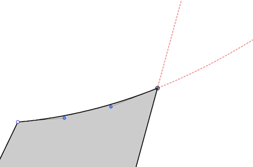

Also:
When dealing with cusp nodes of closed shapes, Option-dragging a node can move it
along the extension of the two segments of that node:
@b77 I will test more the case with cusp corners. These might have problems with the current implementation (no curvature at the node).
