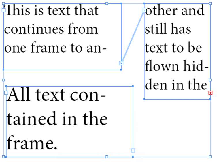

    As an additional note: Affinity apps allow scaling of paragraph text with an additional corner handle (outer than the frame resizing bottom right corner handle). That's ok feature though not so necessary in context of paragraph text.
    But related to paragraph text frames, where the issue of difficulty to graph the handle without zooming in: could the plus sign allowing flowing the text (creating and linking to other text frames) be placed a bit higher and be black if there is no unflown text (and red only if there is text that is still to be flown).
    I think it is ok to have the plus sign so Affinity style "eye" is not necessary (though of course useful if there are issues with seeing colors). On the other hand, InDesign style (+ inside the square only if there is still text to be flown and empty square if all has been flown; a new link and text frame can still be created by clicking an empty square).

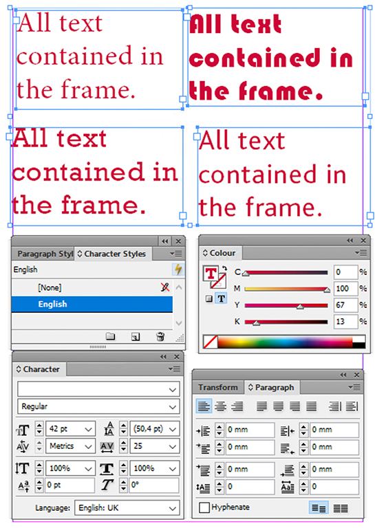

    Here is still a screenshot from InDesign to illustrate this:
    InDesign also allows resizing the text contained in a paragraph frame if you hold down Ctrl/Cmd + Shift. It always happens constrained so basically it is only a method to change the point size of the text contained (currently) in the affected text frame. Affinity apps instead keep the text attributes assigned as per paragraph text frame, which IMO is not a good solution (well, different anyway). A graphic design / drawing app of course has a bit different scope and use than a page layout app so perhaps there is point in having some flexibility and power-edit features at hand (as you have everywhere else). On the other hand, having a robust text tool (something that you do not yet have) is very important so perhaps it is better to add new features only later.

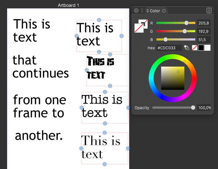

    Meanwhile, back on topic with VectorStyler, I noticed that if multiple "text shape" objects are selected and you try to change the color, only the color of one of them is changed, not of all of those which are selected. That appears to be a bug.
    I could not replicate this issue. Selected multiple text shapes with the pointer tool (make sure that the selection mode is set to the first icon in the context panel). Selected the color from the color panel and it change all text shape colors.

  • @vectoradmin said in Can't grab resize handler when text field is too small,:
    Paragraph alignment should be changeable on multiple selected frames. If it is not, it is a bug, but I could not replicate it.
    At leat in macOS M1 version, this is what happens (it does not matter, which select mode is active, this happens with all):
    ...hmm, it seems I cannot attach a video. Anyway, for me it does not work, if I have multiple paragraph text frames and try to make them all align e.g. to right, only the first selected paragraph frame is affected.
    @Arde Are these frames in the same text flow?
