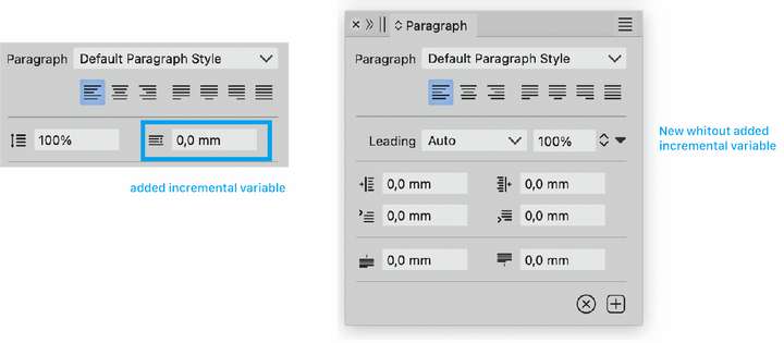

and try to visualize/schematize this for myself. A few questions.For my understanding:
- in your design character leading overrides the paragraph leading?
 - Is an added incremental +/- variable needed for the Auto leading as well as for any optional Fixed and
Gap Leading? What does it have now? See image below.
If you need local adjustments, you do that at character level, right?
It is a bit difficult to try things out in Vectorstyler now because leading and text in general are
still a bit sensitive and buggy. But I will work around that.
