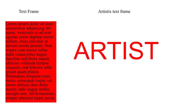

here the Coreldraw way of doing this
color Text is Standard even with Frame Text

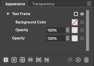

@VectorStyler A separate 'Background color' entry & color swatch when you
expand the 'Text Frame' object with the triangle button:
(Quick mockup)
@VectorStyler OK, could be that the mockup is oversimplifying
things — this background color needs to be added as content
that can accept transparency masks, effects, etc, right?
