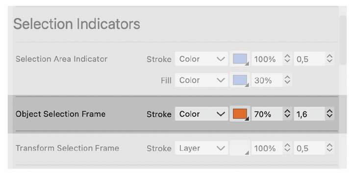

Can't find the Object Selection Frame

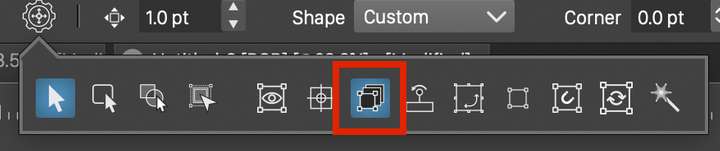

Can't find the 'Object Selection Frame' anywhere. What kind of object/tool can I use to get this frame under my pointer? Or is it a non-working remnant of the Indicator Styles reorganization?
@Ayo Shown for the selected objects in "Transform Each" mode (other than the last object, for which the normal frame is shown).

One last thing in this category that I can't make visible:
- Center Snapping Indicator
Can you give me some direction for that?
@Ayo said in Can't find the Object Selection Frame:
When you move the pivot (center) point, it should temporarily show a snapping indicator to the object origin point.
(the object origin is not always the center, for example for point text it is the starting point of the text)
Aha, but it is hidden under the pivot point itself with normal settings. Only if I increase the line thickness extremely to, say, 8 point, then I see it.
I will look into this.
