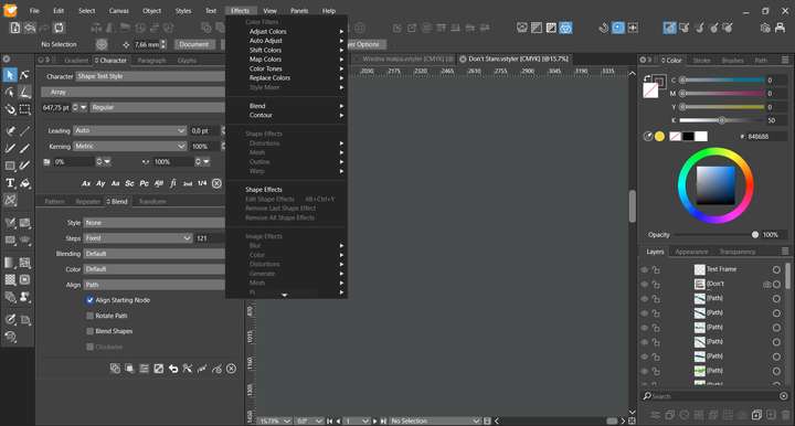

@FastVector said in Select-menu out of line and can't find customize in view-menu:
When I hover over the topmenu and go over select-menu it pops to the top of the screen. And when the program is filling the bottom half of the screen, all the menu's are going partly out of the program window, except the help menu. Anyone having the same issue?
And when hitting the view-menu and going all the way down I can't find 'customize' in which you can find the application menu, contextual menu etc.

@VectorStyler said in Select-menu out of line and can't find customize in view-menu:
If the menu does not fit into the screen, there should be a small knob at the menu bottom (downward triangle), hovering over it will scroll the menu down.
In my opinion, we have another issue here.
For some menus, is there a need for this knob to scroll the menu down at all?
On my 125% scaled screen, I have plenty of room to expand most of the full menus. It is also visible on the @Subpath video that this little knob only expands a few lines of the menu that would fit the screen anyway.In other words,some menus are shortened by the downward triangle too early:
