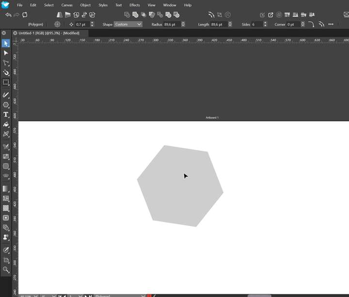

//example//
Hi, yes, there's still that error saying it only works with AltGr.
Another thing that bothers me a bit... is that the Path interface is a bit unstable because you switch between modes a lot.
For example, if I switch between the node tool (A) and Shift + C (anchor point), it deselects, and it's weird.On the other hand, the quadratic segments 1, 2, 3 mode works much better, more fluidly.
What I'm saying is that for some reason the same functions are optimized in one part and get stuck in the other.
