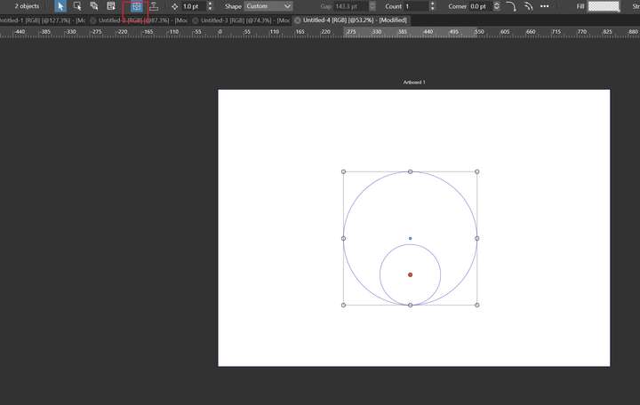

replicate steps:
- draw 2 circles like the image below shows:(align the inner circle to the bottom center of outer circle)
- enable the transform pivot point editing by click the button in toolbar
- drag the outer circle's pivot point towards its bottom and snap indicators don't show, causing it unable to align the point with inner circle's center.

Tried to replicate this. The first one I can't replicate. And the second one I run in the problem that when I enabled the pivit point it doesn't appear. (I also tried it in the beta version, and there I don't see any problems, but thats not the version that you are using).

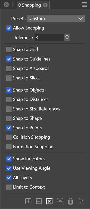

Just a question which checkboxes do you have enabled in the snapping panel. Maybe you can make a screenshot of the panel.

As for the snapping issues, this did not replicate also, what are your snapping settings?

Here is the screenshot of my snap settings menu:
As we can see, I enabled the "Snap to Objects", "Snap to points" option.

For snapping issue, few moments ago I tried to enable "Formation Snapping" option in the snapping panel and another form of indicator appeared and help me with aligning pivot point with the inner center. But I still can't see indicators appear in @Li-Xiao 's video.
