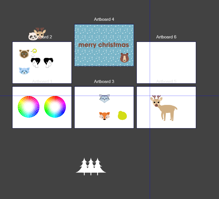

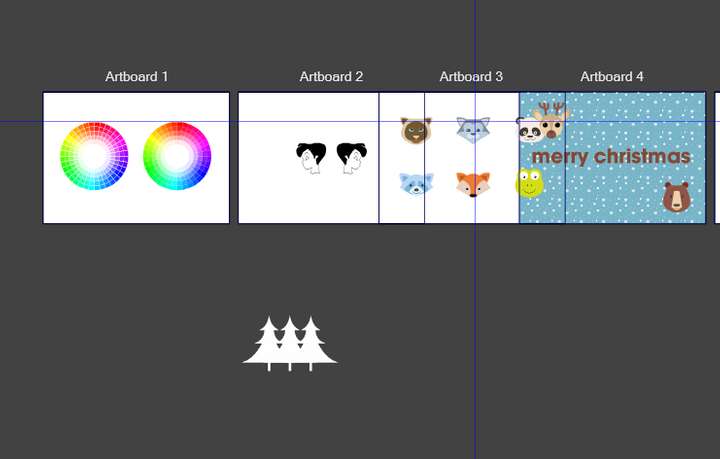

When trying to arrange the artboards in the canvas. Artboard 3 + 4 are overlapping other artboads and some objects are not staying in place on the artboards.

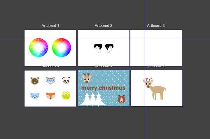

First Image is my starting position. And the other images are from after using arrange artboards
