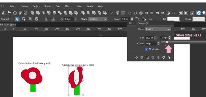

    So I have been in the dot dot dot dialog (because I was looking for the ratio lock button) for a group (the flower). And while trying out things, I noticed that when I drag one of the size sliders (the x one), then the shapes in the group got resized individually.
    Is this resizing behavior optional? There are Non-solid-Groups and Solid-Groups? My expectation was that the shapes would go a long some transformation that is just there to resize the group as a whole image, as if it were a solid thing, a bitmap.
    So, I'm unsure what is wanted VS system behavior, and what could be a bug. It's not a bug when things inside a group scale individually. It's just, that the "image the group is meant to give" is a bit destroyed afterwards.

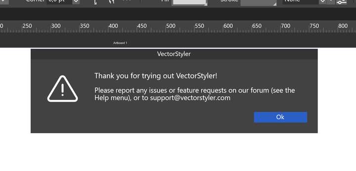

    At the end it displays a message to tell the problems that may have occurred
    Can you upload a screenshot for this message?
  • @VectorStyler
    This one I meant.
    ...or did you mean I should make a screenshot to reproduce the issue? I was not sure whether it's a feature or maybe a bug. I'll try to make a screenshot or two.
  • @markus
    That's the issue I was referring to.
    @markus said in I'm a bit lost in options:
    Justa simple message to let us know if there are problems 🙂
    Yes, in case of the "Shape" panel. This is because the Shape panel edits the individual Shape properties (multiple if selected).
    Use the Transform panel to change the group size.
  • Oh I see.
    I was expecting it to make any scale slider be like the transform scalers, because the other editors are much like that.
    Anyway, now I know 😉 (in fact, I knew last time when I got help here, then fell back to old habits and didn't understand what's going on)
    Thanks a lot..

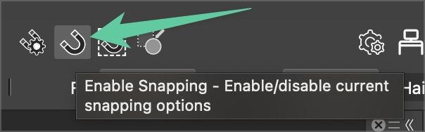

    By chance do you have the snapping enabled? In the upper right corner of the screen
    0_1704137712284_dfd25832-e57d-4cfa-818e-a36d2f82907e-BLD 2024-01-01 at 14.25.26@2x.png
  • No, the snapping isn't it.
