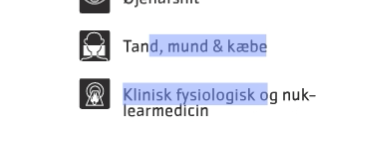

Why do a selected line skip?
Type handling in VS acts like crazy. Why do a line skip ("learmedicin") when I select several? The font is Cachet Pro and VS seems to have a hard time to manage different fontsets.
https://recordit.co/BnwejDmq4h
@Raaskot Tested with the 1.2.008 Beta:
I cannot replicate it — seems to be working as it should here: https://recordit.co/jeVIFvBv7T
@Raaskot I am also unable to replicate this issue. Please try using the "Restore Defaults"
@Raaskot I opened a bug on this one, and will try to replicate and fix ASAP.
There might be a few regression in this new build.Was this 1.2 or 1.1?
@Raaskot Replicated. It is a bug in highlighting hyphenated words.
