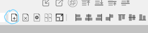

 - With the artboard still selected, in the Context Menu at the top, click on the icon with the tooltip, "Create a new artboard using the format of the selected artboard, circled below in blue:
