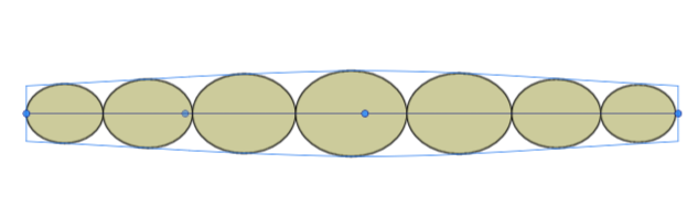

- Using line tool draw a line
 - Apply a scatter brush (screenshot below)
 - Using stroke width tool change width. The first change works ok. Adding another node causes program to freeze.

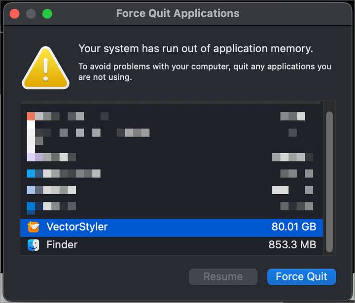

 - Close VectorStyler using Force Quit (see screenshot showing system memory).

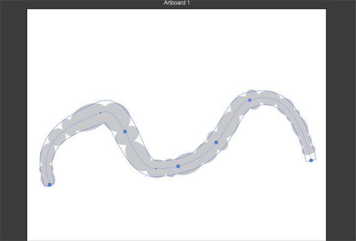

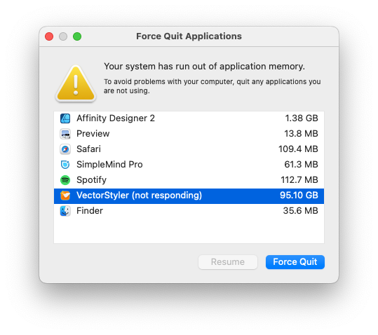

I was able to replicate the same issue but it took adding more nodes and trying to use the stroke width tool further before it eventually froze on me
Here is a video where it froze while using the path width tool
Here is the file I recovered after force quitting:
0_1705507425736_width tool freeze.vstyler
The variable width support for scatter brush new feature seems awesome when it works! I hope the bug gets resolved because I could make good use of that new ability.
@Boldline Got it. It can be replicated here also.

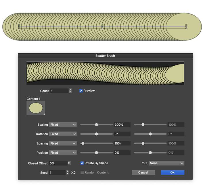

File attached in case you need another example, and a screenshot of the settings I was using. (increased scaling and decreased spacing)
