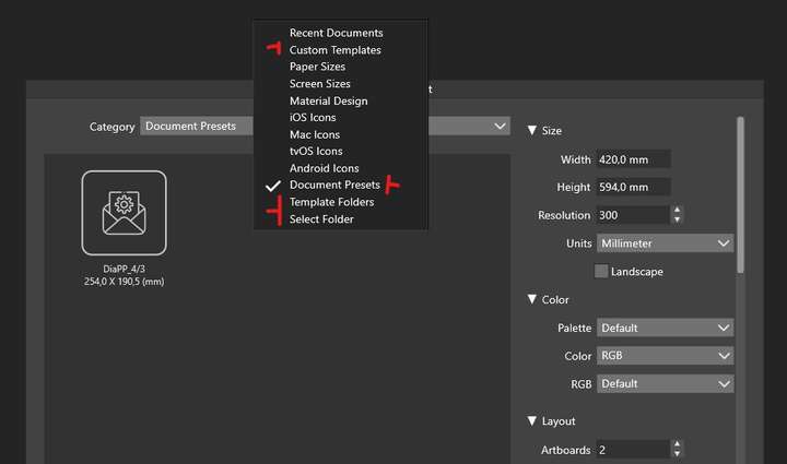

I can be a bit slow on the uptake sometimes but I'm also a bit confused by all these saving possibilities when creating a new document. I understand all the paper formats, screen formats, etc., but between 'custom templates', 'document presets', 'template folders' & 'select folder'... for what situations would it be useful?
Thanks
@Pat said in Add an option in "Document Setup" to save current configuration as a new template option?:
custom templates
Files, regardless of location can be marked as templates with the File -> Mark as Template command. These are listed here. And these will be whole files, with content, not just document options.
document presets
Presets consisting of options edited in the Document Setup view, these can only be created for now in the document setup view.
template folders
A set of folders specified in Settings -> Folders with the "Document Template" folder mode. These folders will contain vstyler files, that can be used as templates (no need to Mark as Template).
select folder
Same as above, but here the user selects a specific folder using the "Select Folder" button. The content of the folder is listed as template files.

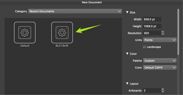

I currently have a custom template I made, but it only shows in the "recent" folder, not in any other folder. Is this normal?

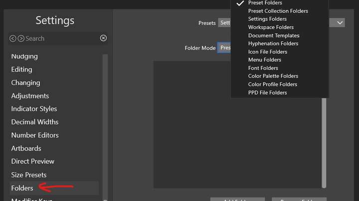

@VectorStyler Here's some new information for me. I suppose that it is here:
VS is a really amazing program, but -as I don't use it all the time- there are so many options everywhere that I can be mentally overwhelmed as soon as I open it. Just defining a new document can already be seen as a complicated task with all those options. I like to understand how the software works (with all these options) and to do this, I need to be able to analyse the different possibilities in concrete cases. What's the advantage of this or that option, in what situation, why this and not that... ?? For me, this is what's missing in the documentation (concrete cases) or as tutorials. Maybe I'm getting a bit old to be trying to use VS
Yes, you need to add one or more folders to the list, with the "Document Templates" mode selected.
