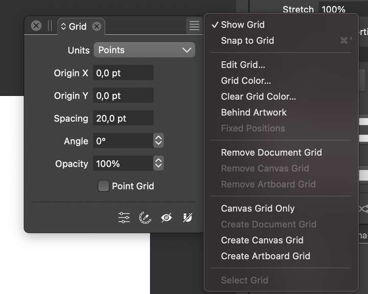

Here are the settings for a new document

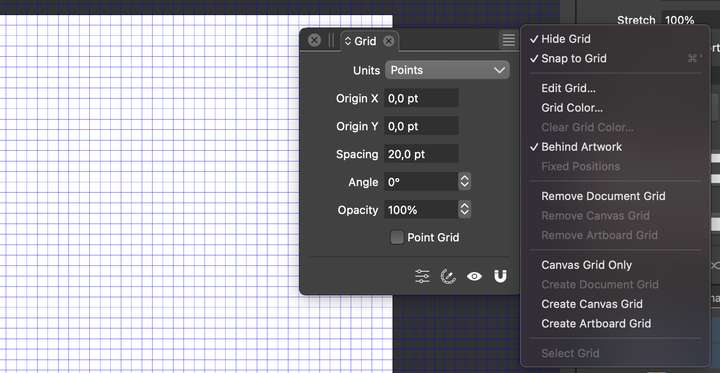

Here the settings of an old document, where the grid is displayed, but I can't deactivate the grid anymore.
