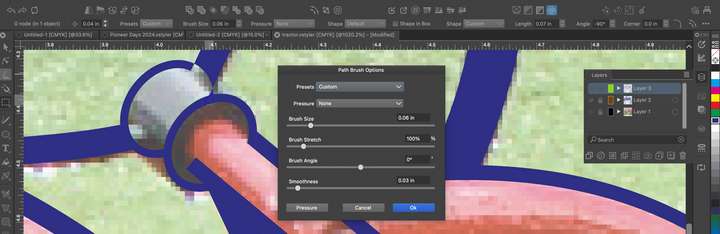

Path Brush option to toggle rope option not visible to me on 16 inch mac laptop
Unless I am not seeing it in plain sight, the option to toggle the rope for the path brush is not visible on the contextual bar when using VS on a 16 inch laptop screen. Would it make sense to add it to the Path Brush panel itself as an additional option to toggle from?
@Boldline Added this to the backlog. Maybe it can be fixed by changing the place in the context panel
@VectorStyler said in Path Brush option to toggle rope option not visible to me on 16 inch mac laptop:
Yes I'd prefer it stay in the contextual menu and position it so it stays visible rather than add it to the path brush panel.
What would be the best way to access it in the meantime?
@Boldline The option should be shared with other brush and pencil tools. So selecting in the Pencil tool should also work.
@VectorStyler ok that makes sense and that worked. thank you
