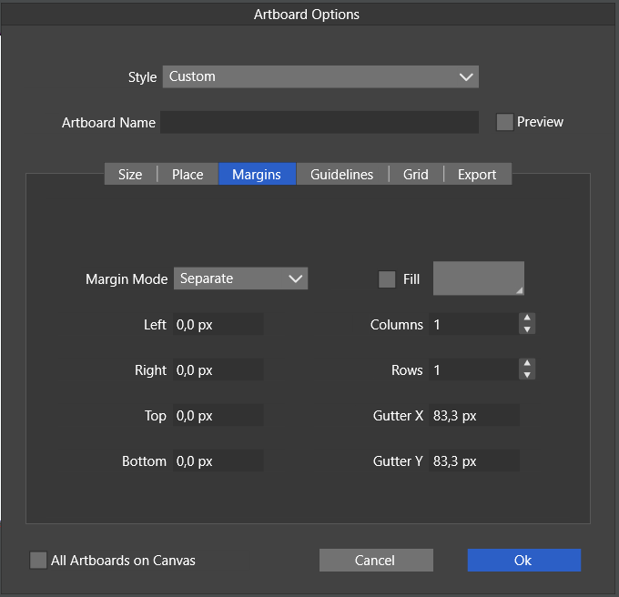

@Harry Are there margins set for this artboards (in the Artboard Options -> Margins section)?
@VectorStyler Here are the margins options:

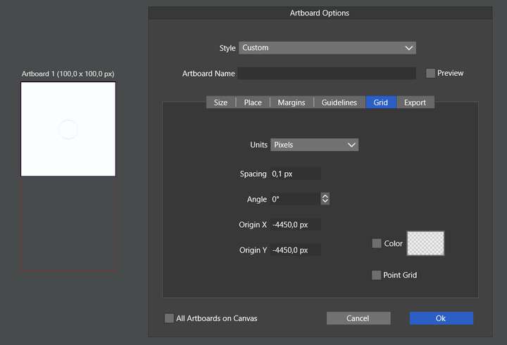

But when I decreased artboard size to 100 x 100 px this problem doesn't exist, but there is an invisible grid set to -4450 px and some rectangular under the artboard:

@Harry Found it: it is caused by the bleed (set in the document options). The margins defined by the bleed (and the center of that frame) are also snapping locations.
