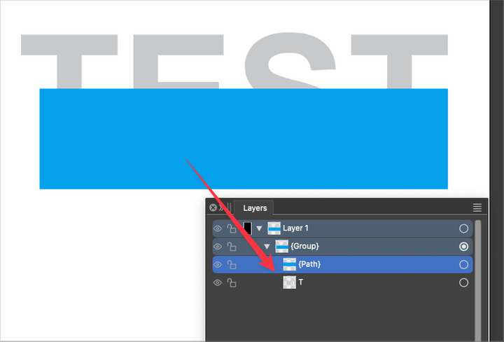

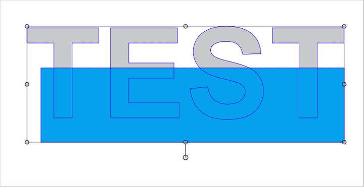

Most of the time, if the shape I want to clip a shape inside of is a composite shape, using "move inside last" will only do half the job. It will link the main shape, in this case the word "TEXT" with the blue shape intended to be clipped within.
I have to go in to the layers panel each time and move the blue shape overtop the clipping shape to complete the task.
I have not been able to narrow it down perfectly. Sometimes it works but usually it does not. to the point where I'm surprised when it does succeed without the second step.
Here is the test file in the video
@Boldline Not really a bug: in this case when you select the two objects, the "last" object is a group, not a shape (this group has a single object in it).
So the blue rectangle will be moved inside the group, which is of course not yet clipping.Best to do in this case to ungroup that single object group first (the TEST shape).

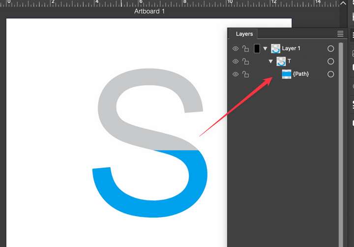

maybe I'm better off using the Control+Command+V option for "paste inside" rather than "move inside last" as the quick way to attain a clipping mask, especially when attempting to do so on a compound shape?
I just tested the "paste inside" with a compound shape and it worked perfectly

I did not find a "Move Inside Last" command in Illustrator, but otherwise composite groups act as groups there also (except styling and rendering).To have a "real" composite shape to act as a shape in all cases (including move inside last) you can create a composite shape (Object -> Composite Shape) instead of a group.
In this case we have an actual shape, and that can be used for clipping also.
